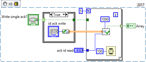

I am trying to understand the behavior of the read/write ack nodes for Messenger channels. A simple example follows. In it I have a Messenger wire.  No message are written to it.  It is only used by ack read and ack write nodes.  The behavior of the 'read Ack' node is not what I am expecting from the documentation.
Some cases:
  1. no ack written, read value=0  :
    • read always returns w/o timeout.  Not what I expected from the help file which says: "The default is 0, which means the endpoint waits for any message to be acknowledged"
  2. no ack written, read value != 0:
    • timeout on first pass. expected behavior
  3. ack write = <anything>, read value = 0
    • this might be said to match the docs, not sure
  4. ack write = <anything>, read value = <anything except value written, and !=0>
    • first read always doesn't time out, second always times out
    • Not what I expected. I expected 1st read to fail since write/read id's don't match
  5. ack write = ack read != 0
    • read returns w/o timeout twice, always times out on third call
    • unexpected behavior. I expected the read to either complete once and not a second time or repeatedly (can't tell from docs).
I didn't find any bundled examples that use these nodes so I am now a bit lost on how to figure out if what I'm seeing is expected behavior.
I attached LV2017 and LV2016 vi's of the code snippet if you want to try it yourself.
Thanks!

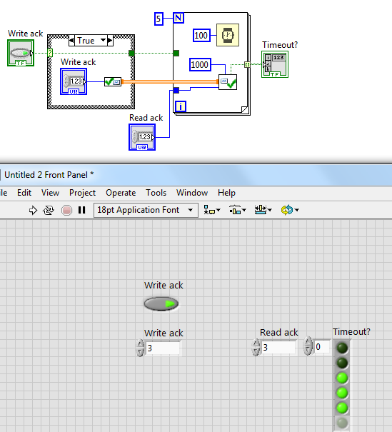

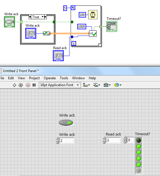

I changed the test setup a bit, yours is a bit too confusing for me.
1) In this situation, it seems the reader simply returns immediately (since the message channel is not initialised?). The default channel to wait for is 0, but since it's not initialised, it will just stop waiting... Might not be expected, an error out would be useful.
2) I get a timeout on all passes. As expected.
3) There is a message, so it stops waiting, no timeout. As expected.
4) I get a timeout on any pass. Since the request ID was not send, as expected.
5) Returns immediately the first pass, timeout after that. As Expected.
So the Read Ack will wait for a time out period for the requested message, if the request message is 0, it will stop waiting (but doesn't clear the message). If the message channel has no writer, it stops.
Message 5 of 10
(7,790 Views)

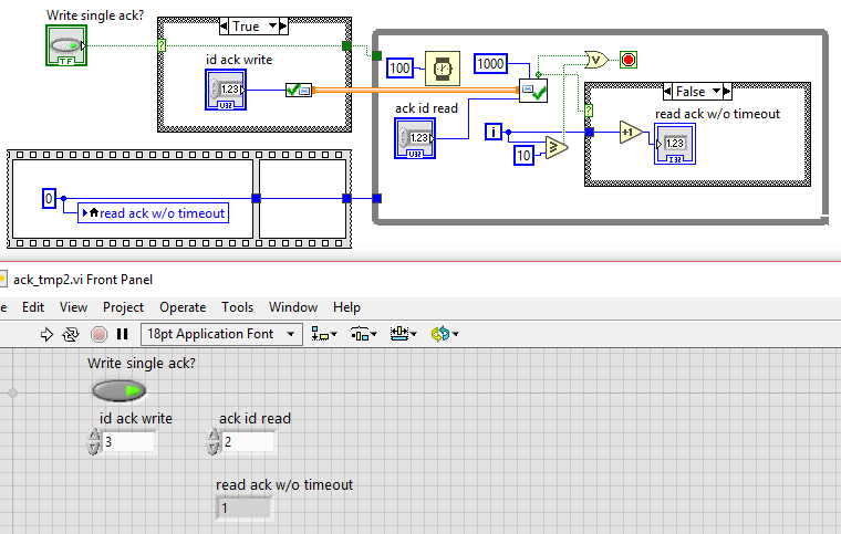

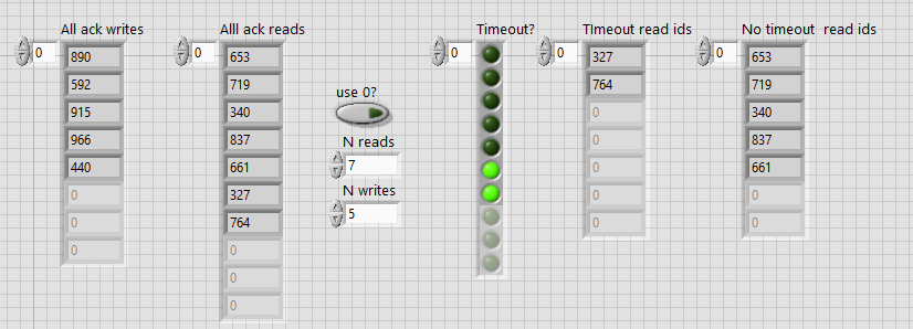

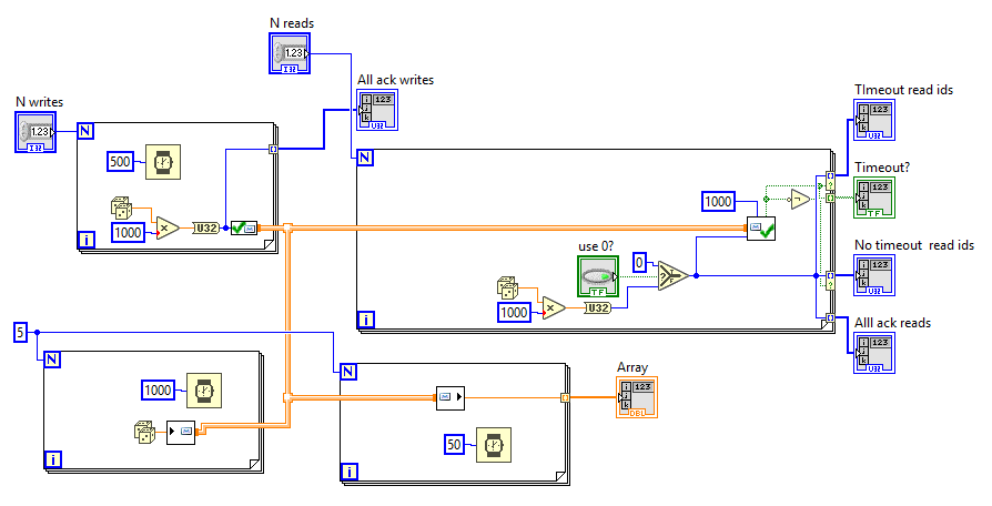

Yeah, either I am missing entirely the way this is supposed to work or the ack part of the framework is busted.  Really doubt NI would release something completely broken though. Does anyone use this?
Only conclusions I have as of now:
1) ack read with id=0 is a no-op.  Regardless of whether 0 acks, a 100 acks are written, ack read will always return immediately
2) ack read doesn't care what the ID of the message is.  So long as there are as many acks written as read calls the read will never block.

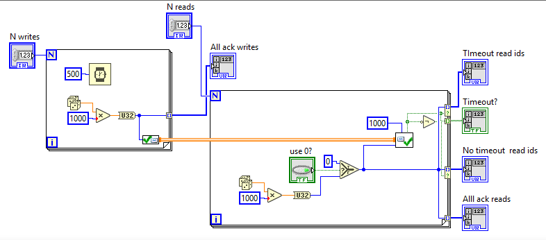

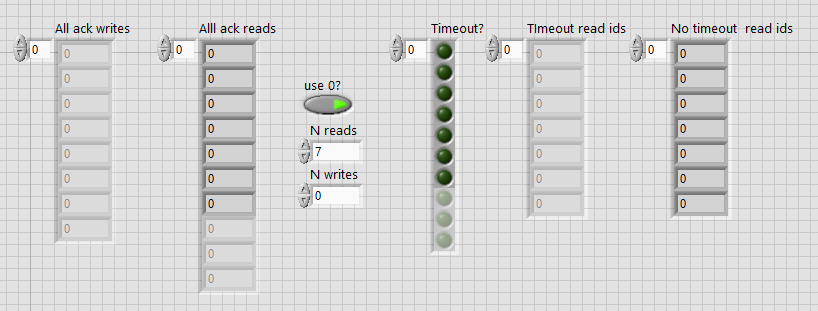

Some additional screenshots below. Also can confirm it isn't some initialization issue, I can pass normal message around fine in parallel with test like above and the outcome is the same.  Some screenshots follow.
generate random ack reads and writesgenerate random ack reads and writesack read id's are irrelevant (if not 0)ack read id's are irrelevant (if not 0)ack read w/ 0 is a no-opack read w/ 0 is a no-op
More elaborate BD with background message passing.  (outcome is the same)
