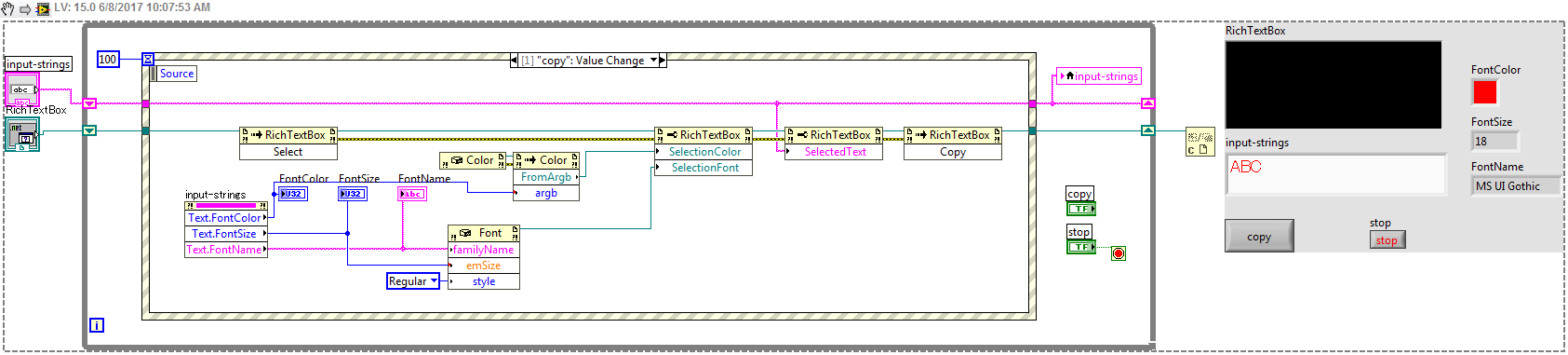

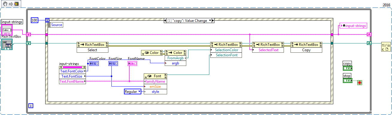

I don't know if this answers your question. But this might get you headed in the right direction.
If you hover over the property node with the (help dialog) open it will reveal the .net class type that is required for those properties. Then you can use a .net constructor node to generate the necessary properties. (be sure to close the reference properly here (I left some open))
You probably want a 2015 snippet 😉

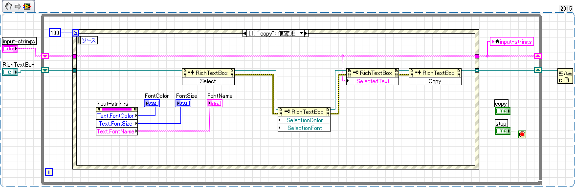

Thank you for your detailed advice.
2015 Snippet too
