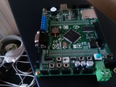

recently I have a board that is arm cortex and compiled with labview
I am work on it but it is not public yet

Dear Fouladi
is your board ready to come to service? is it able to connect to a graphical LCD with touch?
