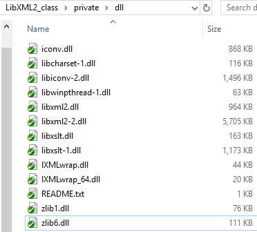

I'm not sure what version it is, but I got hold of them in 32 bit version in March 2016, and the 64 bit version in November 2016.
And they have worked fine in all LV versions since then, but just now Win10 starts to complain from time to time.
If Windows doesn't goes nut my application that uses the library works flawlessly.
I'll look into your links to see if I can find some more resent dlls, these are the DLL my wrapper are using:

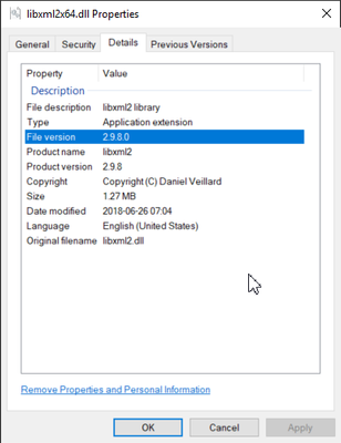

Need to know dll version...
Troy - CLD "If a hammer is the only tool you have, everything starts to look like a nail." ~ Maslow/Kaplan - Law of the instrument
Message 14 of 25
(9,045 Views)
None of the DLLs I'm using is showing any version info.
But I followed your link (https://www.zlatkovic.com/pub/libxml/64bit/), and downloaded all 64 bit versions dlls and replaced them with mine, and now (so far) LV can open the projects without any problem Windows errors, maybe this issue have been solved...I'll keep you posted, thanks for your help.

Just noticed that I the library didn't work when I opened it in LV 32 bit.
The reason was that the latest LIBXMl2-2.dll (64 bit), is referring to ZLIB1.dll now.
The old library I had was referring to ZLIB6.dll. Not a big issue if I only wants to support 32 bit.
So I separated the 32 and 64 bit Dlls in separate folders and re-linked the CLNodes. Then I can load the library in both 32 and 64 bit LV. But I get nasty conflicts if I try to build an exe file 😞
So one solution is to find find a libxml2-2.dll that is built and pointing a 64 bit ZLIB with a different name.
Message 17 of 25
(9,005 Views)
I fixed the build conflict, by removing the dlls from the lvclass.
But I can get the build working correct, one trick I had to do to get the builds working was to refer to the dlls the LXMLWRAP and LIBXML2 dlls is using. Otherwise LV will not add them into the build data folder.
But since the zlib1.dll has the same name in 32 bit and 64 bit, there is a conflict in.
So...
The attached class works both in 32 and 64 bit in LV development environment.
It works find for 64 bit executable (the zlib1.dll is placed in the data folder)
But for 32 bit executable, you have to manually add the  32-bit zlib1.dll into the data folder 😞
