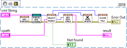

Hi all,
I'm trying to select the "log" node inside an XML file.
Any idea why it doesn't work?
Below there's an extract of the file.
I've already validated the XML and there's no error in it.

I believe this has to do with the root element default namespace declaration in your XML: xmlns="http://www.witsml.org/schemas/1series"
See here: https://stackoverflow.com/questions/3135175/libxml2-error-with-namespaces-and-xpath
Child elements aren't required to be qualified (with a namespace prefix) in the XML doc, but technically they are required to be qualified with a namespace in XPATH queries.
libxml2 does have the function xmlXPathRegisterNs to register a namespace so it can be used in XPATH quesries but that function doesn't seem to be implemented in the IXMLwrap.dll for us to use in this LabVIEW wrapper version of libxml2.
So I think you have 3 options.
  1. Remove (or add a namespace prefix to) the xmlns declaration in the XML doc root node (quick way to test if this is the problem)
        Then this XPATH will work: /logs/log/data
  2. Use XPATH queries that include a function that searches the default namespace:
        /*[local-name()='logs']/*[local-name()='log']/*[local-name()='data']
  3. Find, modify and recompile the source code for the IXMLwrap.dll to include the xmlXPathRegisterNs function, then register the namespace to use in your XPATH queries.

Thanks TroyK, that's exactly what I need. Unfortunately, I don't have control over the XML format but using the second option does the trick.
