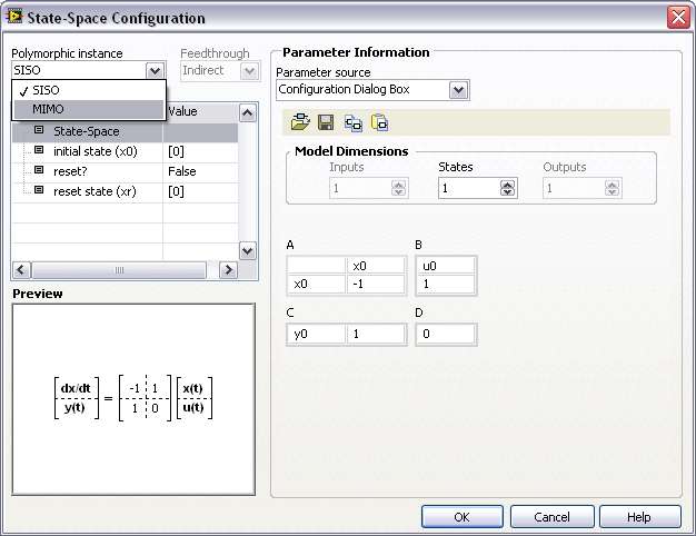

I am running is simulation with MIMO system represented as state space in control design and simulation toolkit. I see that I am not able to give vector with 2 inputs to the MIMO model. By default state space is represented by a SISO model. Can anybody guide how can one give two inputs to the state space model and run it as a MIMO system.

You should be able to double click on the State-Space VI which will bring up State-Space Configuration Dialog Window. You will be able to use the drop down Polymorphic instance to selec a MIMO system. Or another way of doing this is to change the parameter source to Terminal, then wire in your MIMO model directly.
