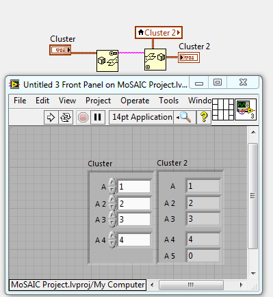

What I EXPECTED, when unflattening the string into a structure that's bigger than the original, was to get good data, up until the string ran out,  and then get FALSE / 0 / 0.0 / "" for the remainder, since there is no data to put there.
That's what happens if I unflatten a string containing { A | B | C | D} into a cluster with { A | B | C | D | E } - the A,B,C,D values come out OK, and the E value is default.
Here's proof:
But that doesn't happen if one of the elements is an array.
Why?
