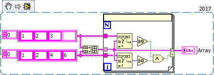

I'm comparing the two input arrays, I'm in need to determine the mismatch elements between two arrays.
I've attached the image for the reference.

I got struck at Array indexing while using with nested for loop.
If 1st input array index was enabled in outer loop, then I can find only the missing element from 1st array and Vice versa.
So I've to find missing elements from both input array inputs.

Your VI uses a different approach than my suggestion - maybe that's the problem? 😄
Attaching just images of code doesn't help a lot. We cannot debug/test your image with LabVIEW.
Please attach your VI!

I've attached the snippet.
Can I do this both mismatch elements functionality within single nested forloop?

Hi Padmananbad,
sure you can do it with just one loop!
As I described by the pseudocode above:
