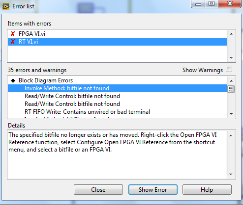

I recently downloaded an archived file (cRIO Acceleration and Strain Data Logger Reference Example (Archived)) from the ni website and ported it to my cRIO 9024 (with a 9113 chassis) and it appears a file is missing. It loads everything and asks for Burton.lvproj_FPGA Target_FPGA VI.vi.lvbit. This then messes up my RT and FPGA vi's (see the attached image below ), rendering the code un-usable. Does anyone have this file, or know where to find it? I have all of the components (9233 and 9237 cards) and a project file with the files from the downloaded added under the cRIO.
I'm running LabView 2014 SP1 and the cRIO is updated to 14.5, for reference.
I looked through the source code from the download link and it was not there.
Thank you for any information you can provide!
 ^error message received in the FPGA and RT vi's after deploying all^

Hi rsmith,
compile a new bitfile or use the FPGA VI when creating the FPGA reference - as written in the error description…
