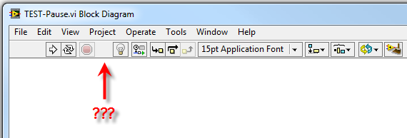

Hello, colleagues,
Can you explain please - why the Pause Button is missing in the given VI?
Checked all settings - all seems to be good. VI (LV 2013) is attached.
Andrey.

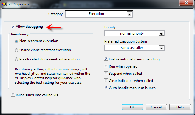

@mjhakkar wrote:
You need to allow debugging from VI Properties:Execution.
I know. Debug is allowed in the given VI:
Any other idea?
