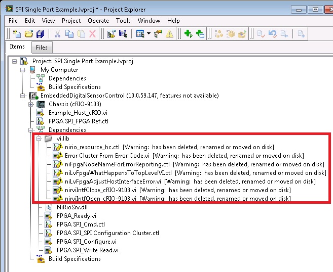

However within the project, I seem to be missing some dependencies that should be located in vi.lib:
Does anyone know how I can fix this?  I originally thought I might be missing a library or something, but searching around for the VIs named in the red box above turned up no obvious results.  Any suggestions would be very welcomed!

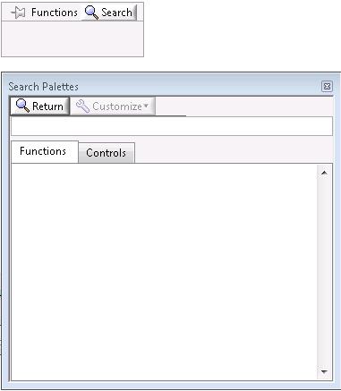

They are part of the Host VI of the project.  But it seems like my entire vi.lib path is somehow off in this project.  My entire palette seems to be blank from within this project:
Is there a hardcoded place where projects store the path to .../program files/national instruments/LabVIEW 2013/vi.lib or similar?  Perhaps I just need to redirect the project's search path?
EDIT 1:
If I make modify/create a VI under the My Computer hierarchy in the project, my palettes show up fine.  However if I try to modify/create a VI under the cRIO target, all of my palettes are blank...  Does the cRIO require a special library of VIs?

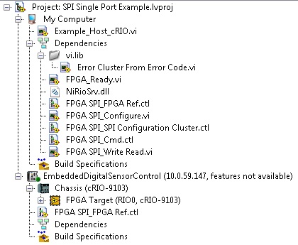

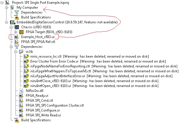

I moved the Host VIs off of the RT target and into the local My Computer hierarchy.  That seems to have fixed my issue 😄  Pictures of the adjustments below for anyone with similar problems:
OLD:
NEW:
