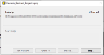

In other cases, I called Dll from visual studio with VI pop-up window. After starting the Runtime engine the search window occurred after finding proper vi, code was running.

Search Window
