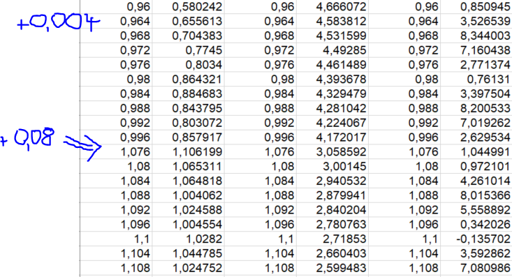

Hi there, in my program a small error occurred.
The following error occurs in all exported files:
LabViewBug.PNGWith the defined task I get all 0.004 seconds 3 values from 3 different physical input channels.
Exactly one second, the time series jumps to another interval. The error occurs only on exactly one second. In the second (2, 3, 4...) The error does not occur!
Does anyone have an idea what problem that can be?

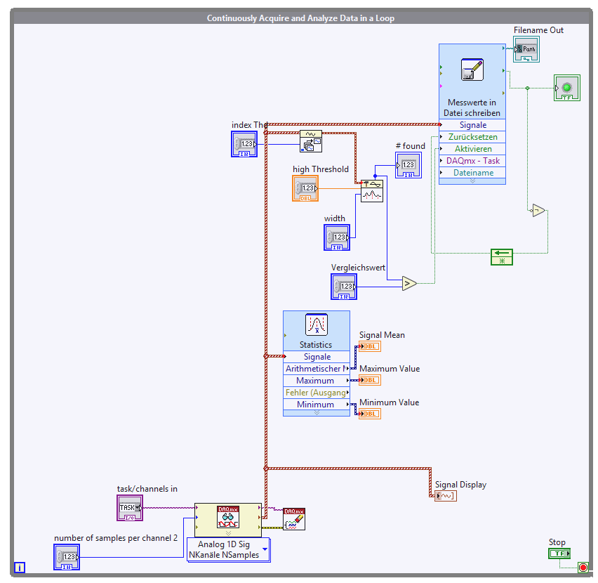

Here is the current Version of the Vi

It looks like you are clearing the task after every iteration, so it needs to make a new task each time.
  1. Create task outside loop
  2. Clear Task Outside loop
  3. Only read samples inside loop.

Good catch.  I completely missed that.
That would effectively kill the positive things about Continuous Samples.
