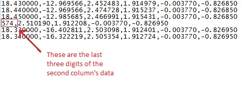

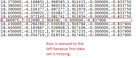

Here's how the data comes out on the file:

Thanks for all the responses guys. I really appreciate the help. Unfortunately I can't post all the code due to company security policies but what I can do (I believe) is post parts of it ;). This part of the software is basically a queue state machine that receives commands from another queue, this queue is self contained and nowhere else in the code is the file reference touched other than here. Also inside this state machine only the part you see on my pic is the one that touches the file once the reference is opened. I will post this queue, just give me a few minutes so I can "prepare it".
Meantime I found another instance where only the last part of the second data set (second column if you wish) are present on the file Smiley Surprised. What you guys think about that ?
