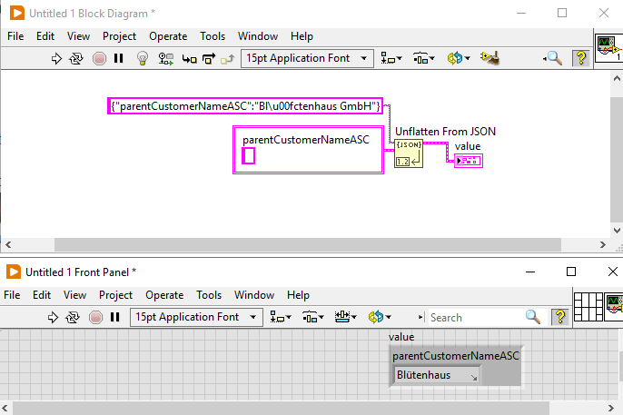

I installed your update and I am not sure where I make the mistake, but I am not getting the correct output.
The string that I am using as input is the following:
[{"@odata.etag":"W/\"Jn\"","status":"Released","no":"101010","description":"ECO","startingDate":"2021-03-31","startingTime":"08:00:00","endingDate":"2021-03-31","endingTime":"23:00:00","dueDate":"2021-04-01","quantity":2,"m365SalesOrderNo":"1596","parentCustomerNameASC":"Blütenhaus GmbH","m365SalesOrderLineNo":10000,"salesOrderNoASC":"","customerNameASC":"","salesShipmentPositionASC":0,"itemNoASC":"","priorityCodeASC":"","startMachineCenterASC":"","productionAreaASC":""}]

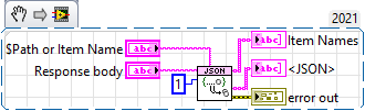

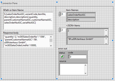

I attached the code that I use:
But the result still seems to be the same:
Thank you for your help in advance!

Accepted by topic author Universaldilletant
I can see in your screenshot that your JSON String is "Bl\00fctenhaus GmbH", so that is what that function returns.  Perhaps you want to convert that to the ordinary sting 'Blütenhaus GmbH'?  In that case you need to use a function that converts from JSON format to regular LabVIEW types, like "From JSON".  It can get confusing understanding the difference between a JSON string and an ordinary string.
