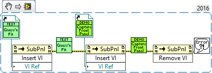

You might investigate subPanels in LabVIEW.  This lets you designate a region on your Top Level VI (it looks like a "window", or a sub-Panel) inside of which you can see the Front Panel of another sub-VI that may-or-may-not be running.  Of course, you want it to be running ...
Here's how simple it is to set up (the hardest part is to get the two Front Panels sized the same and sized to fit into the sub-Panel of the TLVI (Top-Level VI)).  Let's say the two VIs are Test Gaussian Fit and Capture Front Panel (these are two sub-VIs I happen to have lying around),  They are ordinary VIs that run when you call them and stop when they stop (because they're done, you tell them to stop, whatever).  So here is code that loads Test Gaussian Fit into the sub-Panel, runs it, waits for it to finish, then loads Capture Front Panel, runs it, and when it exits, turns off the sub-Panel.
As you can see, the code is very simple and straight-forward -- you run the two VIs in series (since they are sharing the same sub-Panel), "showing" them just before you run them the simple LabVIEW way, by placing them on the Error Line and having the Data Run Through It (I didn't show the data flowing in and out, but this is cobbled together to illustrate the point).  No fancy passing of parameters.  You can even (if you want) run both of these in parallel, and have two sub-Panels, one for each VI (you are only limited by your Imagination and Screen Size).  Took me 10-15 minutes to code this up (I had the sub-VIs already), faster and simpler than C++, I'm sure ...
Bob Schor
