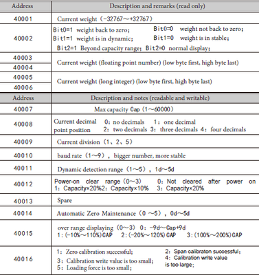

Below, I’m attaching:
  • The transmitter’s Modbus protocol document
  • MarcusP_0-1745496719305.pngMarcusP_0-1745496719305.pngMarcusP_1-1745496735041.pngMarcusP_1-1745496735041.png
  • A screenshot of my LabVIEW application
If anyone has experience with this kind of setup or has any tips (especially around correctly reading registers or setting up the communication), I’d really appreciate your help!

I just took a brief look at the VI you attacked and at least two things stood out (no guarantee that there are not other things);
First off you try to write two doubles to holding holding register 0, which in this case means registers 40001-40006 in the supplier's specification, which are defined as read only...So you probably get an error back on that, which affects the next step where you try to read 6 registers from 40036, which you for some reason interpret into a 9-element (!) cluster of U16's which does not make sense as they come in as 6 U16s already and you can just use array index to get to the U16 you try to display.
Strip away the write, skip the loop and set the read to address 0 and the number of holding registers to e.g. 1 and just see if that returns something (display the error cluster in the loop to see any errors as they come). Tell us what it says if you want further support...
If that returns OK you can start to add more and loop things. Use a third party master to verify that you should be able to do this with your software (make sure you close LabVIEW before so the serial port is not blocked...), and if needed compare the poll command sent on the serial port form that software with the one you generate (if any) with your LabVIEW code...Once they match you can expect your code to work too.

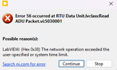

Okay, so I don't know what to do. For some reason, now it just shows this error no matter what.
Maybe it's the driver, I just don't know. I tried uninstalling everything and reinstalling it, but in the end, nothing changed — and I just don't know what else I can do.

This is not a ModBus problem. ;Your serial link is not working.
RS-485 is a very good interface if it is setup correctly.
Can you show me the connection. How long are the wires between the device and the computer.
Have you tried to swap the A and B (or + and -) wire ?
Some manufacturers use notations as A- and B+. Very confusing.
Kees

This seems like a TCP terror, have you accidently changed the type from serial RTU to Modbus TCP?
Message 7 of 15

There was a broken wire in the RS485 connection.
After fixing it, everything is working properly now. Thanks for the help!
