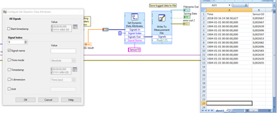

I have a question about the logging/saving to file - in my excel-file I get a bunch of "#" in the time column. What is the reason for that?

So, the Time column shows a static date/time (except the first Time stamp). I have tried to change some time settings in the "Data Attributes"-block before the "Save Measurement to file"-block but this does not change the time.. I want the time to start from 0, without the date..

I think we'll need to see your actual code to troubleshoot that. Generally it's advised to stay away from Dynamic Data, because it just obfuscates what's really in the wire.

Is there another way to put a header (in the excel-sheet) for the input signal and change the Time column to just showing the sample time and not the date/time stamp?
