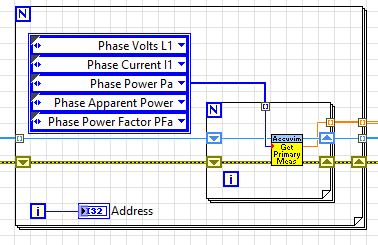

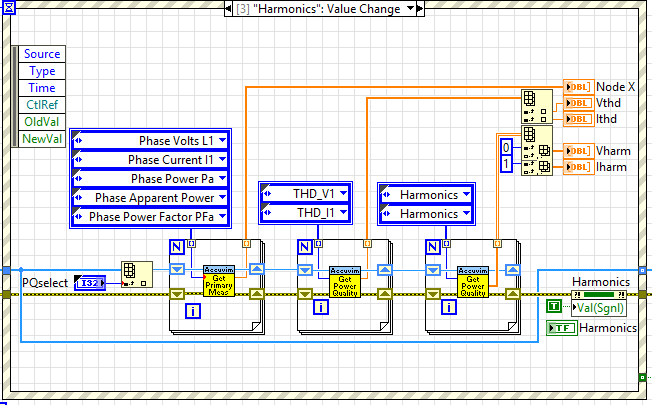

I have a test system that has 12 Modbus devices on one RS485 using a USB to RS485 adapter that installs a virtual serial port.
I am using the NI Modbus library inside my VI's
 I initialize all my devices using a For Loop, the class wire then becomes an array.
Taking measurements uses the same method and auto indexing steps through all 12 devices
If I only want to measure from one device I just select it first
Thanks for the reply on an old thread.      🙂
I've got a similar hardware setup, and I believe this is exactly what I was looking for.
Thanks again.
