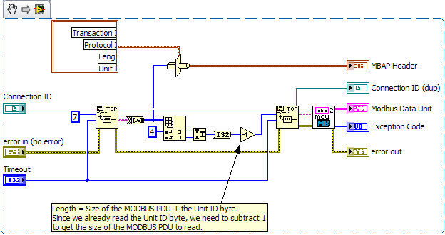

The code below was taken from the NI Modbus library:
The first TCP Read VI, reads 7 bytes as a binary string. The data string is then cast to the MBAP_Header data type.
The MBAP header contains a length field, that is used to determine the length of the Modbus PDU (i.e. remaining part of the TCP message)
The second TCP Read VI then gets the remaining part of the message.
Can I set the second read timeout to 0?

Hey,
The second read should not have a time out of 0.  The first read only gets the first 8 bits of data, it does not buffer the rest of the package so the second read still needs time to receive the remaining data and hence will need at least some sort of time out value.
On the subject of segmentation, I believe you are correct.  As long as your message doesn't excede 1492 bytes (I think the 1500 includes the overhead of the Ethernet package), it should come down in one package.
The best thing you can do is to try it out.
