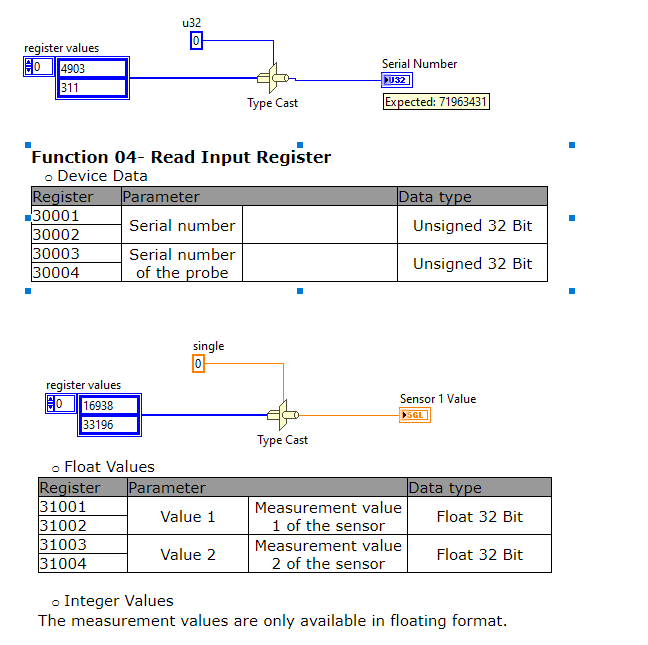

Hi all.  I'm trying to convert these register values into a serial number and sensor value using the info from the device manual pasted below.  Any help would be much appreciated.  Thank you.

If you expect 71963431, the registers should be 1098 and 4903. I suspect you are reading registers 1 and 2 of the input registers, but reading register 0 and 1 will actually return registers 30001 and 30002. Try that, and use type cast on the arrays of u16. Wire any u32 for the serial and a single precision float to the measurement value.

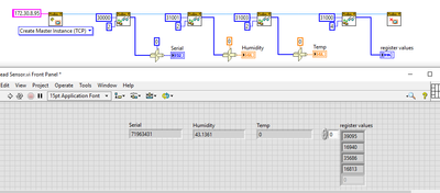

Great.  I'm almost there. Two out of three are working.  I am getting the correct serial number and value 1 (humidity), but I still can't get value 2 (temp).  You were right about reading the wrong registers for the serial number.  I guess I expected the modbus read input register vi to return 30001 and 30002 by wiring 30001 as the starting address and 2 as the number of input registers.  But I had to wire 30000 as the starting address to get the right serial.  Is it supposed to work that way or could the chart be incorrect?
To get value 1, I had to use 31001 as the starting address, which was what I expected from the chart.  But I can't find any way to get value 2.  If I start at 31003 with 2 registers, I get Error -389113 occurred at an unidentified location.  I can read a max of 4 registers starting at 30000 and not sure how to get value two out of those, which is expected to be around 70.
I'm stumped on value 2.  Any ideas there?

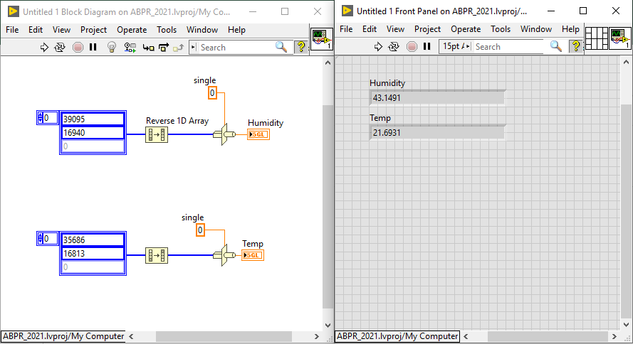

I think the device is sending the registers in different order. It's a bit odd they do it for floats and not for the u32 serial, but if you swap the registers it gives data that seems believable (21 C for room temperature)
So change the read to be 0-indexed and then reverse or otherwise swap the registers before type cast.

Great that does it.  Thanks much!  The funny part is that I did manage to get the 21 temp value before, but derped and didn't realize that it was in C because the device is set to F so I thought it was wrong.  Thanks again!
