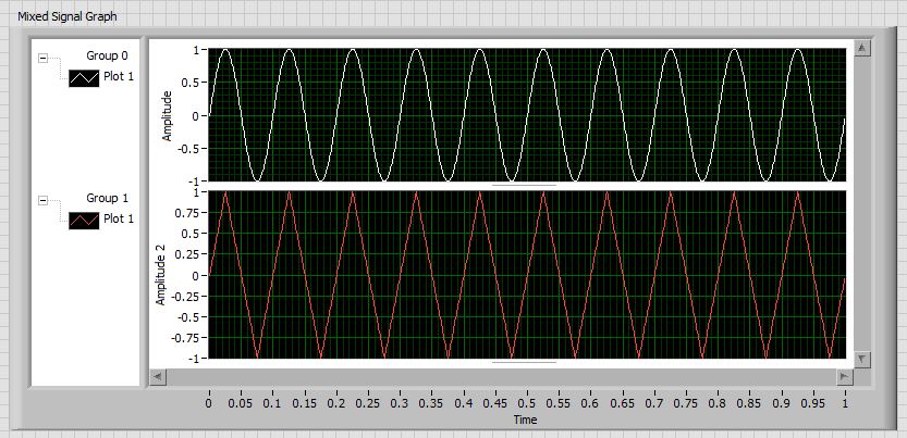

1. Yes, it is possible. Either before runtime or during runtime with property nodes.
2. There are a few different ways you could achieve this effect. Either stack graphs or use the mixed signal graph, although there are some caveats to using a mixed signal graph that may cause issues. A screenshot is below.
3. Yes, set the grid color to transparent.
EDIT: Ooops. I see crossrulz has already provided a solution for 1 & 3.
