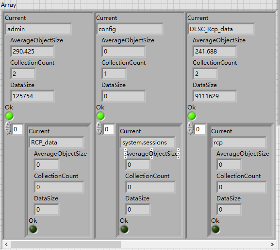

 I try to download mongo.driver.legacy.dll according to introduce. Then Getconnection, Getdatabase, List database and List collection is ok and feedback the database and collection names. But it meets erro when load Getcollection method. It is show invalid parameters.

Databasename and collectionname is feedback
