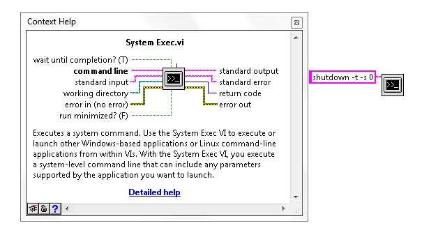

Here's an example.
The System Exec.vi is located on the Functions Palette under Connectivity >> Libraries & Executables.

correction just type "shutdown -s" in command line
That causes a shutdown.  The OP is looking for a way to check if the computer is shutting down.
