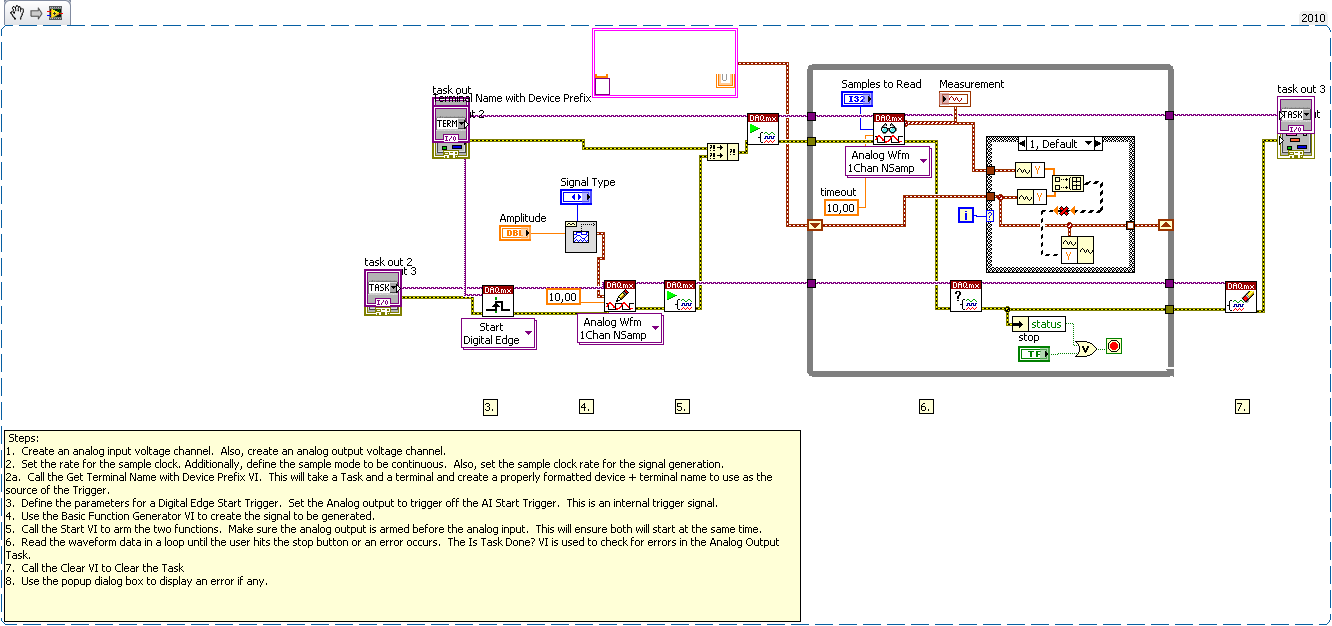

Hi I have a plot that occurs outside a whileloop, and another that is constructed inside the whileloop.
How do I get the plots to run synchronously in the same waveform chart?
I've tried looptunnels, I've tried shiftregisters but neither solves it.
Below is a picture of my attempt to get'em together.
Hoping for some help.

Just to clarify, you're defining a complete waveform and starting to write it outside of the while loop.
Then, while waiting for the write to complete, you acquire another signal asynchronously in chunks, adding data to the chart a chunck at a time.
Because you are using a chart (as opposed to a graph) your complete write waveform will added each iteration to the chart indicator.
(I'm compiling an installer at the moment so I can't provide a snippet to demonstrate right now. Give me another 20mins and I'll post again.)
What you could do first of all is use a waveform graph instead of a chart.
Then using a 'build array' on the 'Y' values, manually build the waveform of acquired data in a shift register and display it in your chart indicator.

This should do what you requested, but it will keep adding data until you hit stop or memory is full.
You'd have to add some sort of data truncate function to limit how much history is displayed.
(The hidden case is 0, it adds the first acquired chunck of data to the shift register)
