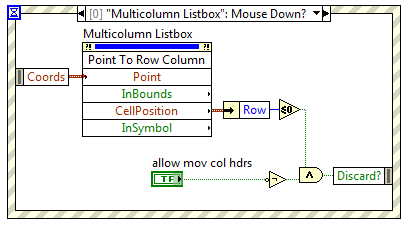

You can code that behavior by filtering the "Mouse Down?" event.
Message 4 of 14

It will only discard the Mouse Down event if it occurs on the headers.

You can't move the column separators from inside the table when the VI is running, only when it is in edit mode.
