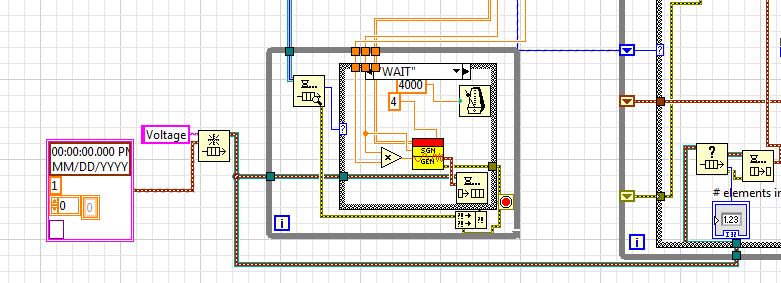

I don't see anybody Enqueuing into your StartAcq queue.  Which means you will just be sitting there forever waiting to a command.  Therefore no data will be acquired.
Also, you really should not be using an event structure to time your loop.  In fact, there is really no reason to limit your loop with a wait.  The continuous acquisition of the DAQ will do that job for you.

Hold it!  I will appologize if this comes out a bit harsh but I want you to re-think!
You are actually using a timeout case to enqueue a "Wait" command to other loops?  WTFWYT?
Now that you face-palmed yourself,  That's actually not bad code style! You have some talent for this LabVIEW thingy.  Take a peek at the "Contineous Data acquisition and Logging" Project template (Really, your code is not that far off that design pattern) and pick up the few pointers you missed.
Nice work!  Now go and  "get'r'done"

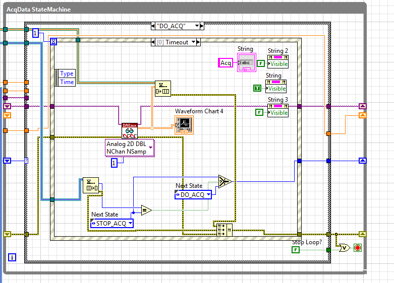

Not directly related to your errors but, (and here I'm not trying to pick on you but......   With an alias like yours I assume you have some sence of humor)
Really????  a single frame event structure with only a timeout case (set to 1mSec) with a Dequeue element in itSmiley LOL  How do you think the code would work by simply removing the event structure entirelySmiley Wink
Spoiler
Gosh Jeff,  Let me see....Uhmmm maybe the dequeue element would just wait for an element to be enqueued to the queue I'm dequeueing from without needing to wait the whole millisecond for the event structure to timeout first....  Yeah....like that  I REALLY hope you do have a sense on humor-  If not accept my appologies.
This is the source of your errors
You are waiting and waiting and waiting to generate the same darned waveform over and over and over again just to enqueue it to the DAQmx write.
Take a trip through the example finder again "Current - Continuous Output.vi"  will demo how to set up a DAQmx task that regenerates a single waveform over and over agian until something else stops the task.  This will involve a fairly large re-write of your existing code but, the great news is you will learn something from the examples and DAQmx Help file.

Rubber Ducking your code can really help. especially when you are new to the language.
"If no events happen fire a timeout and remind all the loops that are waiting for a command that they should wait for a command"  would probably cause the little duck to look at you rather quizically.  Glad to have helped.
