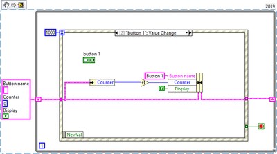

I am trying to improve a bit my user interface (or rather the user experience) :
I have a few buttons sending commands to stepper motor drivers, internally via a message handler structure and then via wifi to a platform where the electronic is.
The system response is slow and the user has to wait for the motor to finish moving before sending a new command.
For various reasons, the user commands only in fixed positions (1 step, 10 steps, 100steps etc. But my software can send random number of steps.) So if the user wants to move to 56 steps (rather not happening but just for the example) then he'll have to click once on 10 steps, wait. Click again, wait, etc. 5 times and then .... you have the idea.
So I'd like to implement a "button counter" which is also recognizing the button itself.
That way if the user clicks 3 times on B1 et right after 2 times on B2, my software will send only two seperates commands.
I came accros this idea that wouldn't be difficult to implement in my soft, after 1 second of inactivity on the buttons, then the command is sent, but if the user clicks 2x on B1 and then 3x on B2, then it will send 5x B2 which is not acceptable.
Any tips to improve this?
Should I create one cluster per buttons so they all have their own counter? Should I use user events instead?
Thanks in advance.
Vinny.

You need to make it scalable. Instead of a counter scalar in the cluster, you could use an array of counters and an array of button names.

Accepted by topic author VinnyAstro
Here's what I had in mind...
Message 6 of 8
(2,758 Views)
I was also thinking of evetually using two arrays, but you made it so simple I clearly need more experience haha
Thanks a lot!
