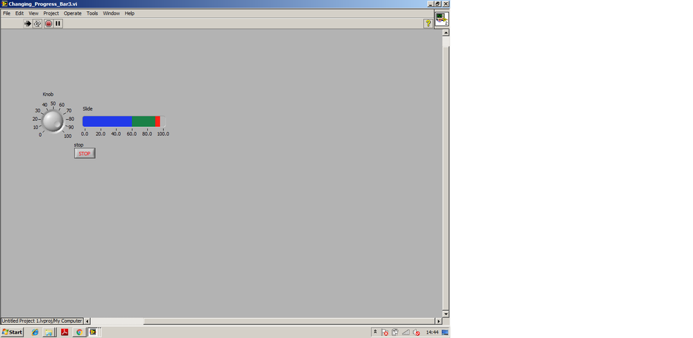

i have gone through changing_progress_bar.vi but i found some problem in your vi. Here i have attached image which indicates my problem in progress bar. Please do needful.
Problem is when we start a vi then red color is by default present below the 0 limit and if we change the limit to above the certain limit for red color then red color is disappear in stating point.here problem is when i run the vi then by default red color is indicate below the 0here problem is when i run the vi then by default red color is indicate below the 0when limit is above the set limit then red color is gone.when limit is above the set limit then red color is gone.
Message 6 of 8
(6,256 Views)
I hadn't noticed that issue.
One way of addressing this is with a couple of property nodes.
Patrick Allen: FunctionalityUnlimited.ca
Message 7 of 8

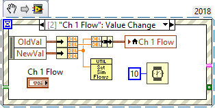

What timing!  Two days ago, I wanted to make a Slide Control to test an Alarm system I'm developing that will send an alarm if a signal is "too low".  I wanted a slider to generate a test signal, and wanted a visual indicator when I was in the "Danger Zone".  Here's what I came up with:
Flow ControlFlow ControlUsing Flow ControlUsing Flow Control
The first is a picture of the Control on the Front Panel.  It looks like a simple Slider Control, but it actually has two Sliders.  Slider 1 is at 100, and shows the dark blue background to its left.  Slider 2 is initialized at the "Danger" level of 40 (via a Property Node), and has its background set to Red.  But where is it?  It is at 40, of course.  What I did was to grab the corners of Slider 2 and make it as small as possible (so that it couldn't easily be "grabbed" and moved).  I also made it Transparent, so "He Cannot Be Seen" (blooey!). lso
I aIso added the Snippet where I show how I read Slider 1 and use it.  When I went to post this code, I realized that I didn't handle the possibility that I clicked on the "invisible" Slider 2 and moved it by accident, so I added the code to reset the Slider "just in case".
Bob Schor
