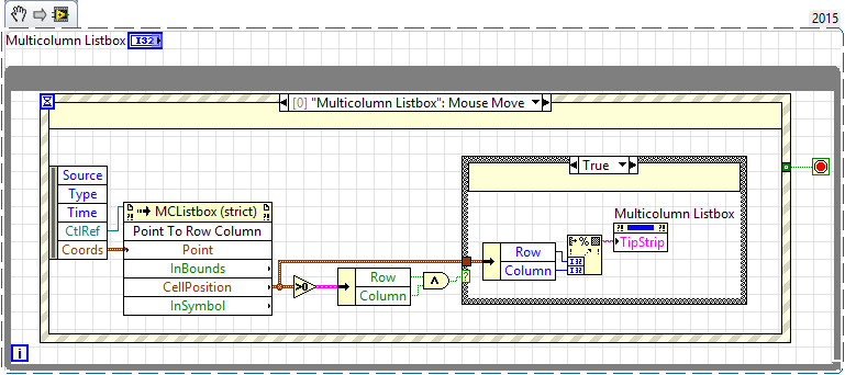

There MIGHT be a better way, but there is a COORDINATES TO ROW COLUMN node that you can invoke to turn the mouse coordinate into a row/column address.  Use that address to set the tooltip text for the entire tree.

Hey, thanks!  That was a simple mod using that invoke node!
But what I noticed was that the tip strip, while being changed, won't appear unless the mouse is actually moved out of the control entirely and then back in.  Is there a way to reset that so the tip strip can be re-displayed without leaving the control?

You could use the mouse move event. However, the position of the tip does not move.
You may need to look in to something like this: https://forums.ni.com/t5/LabVIEW/Tip-strip-utility-VIs-and-some-advanced-techniques/m-p/2576151#M776...

You can TRY this:
Turn the APPLICATION property APP.SHOWTIPSTRIPS OFF.
Turn the APPLICATION property APP.SHOWTIPSTRIPS ON.

The tip strip does seem to move for me.  It appears nicely within the bounds of the cell that is being hovered over.  It just won't reset and re-appear unless I move the mouse out of the control itself and back in.
I read through that linked post and it seems that creating your own tip strip would be the way to go for this.  But that's probably more work than is needed for what I'm trying to do at the moment.  I may mess with that if more time opens up.
