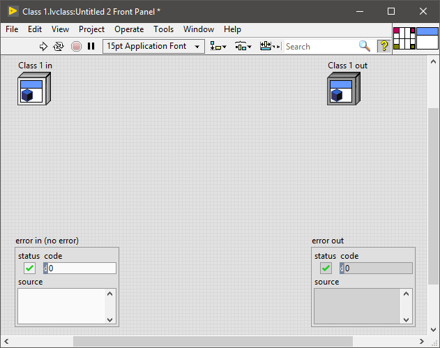

Ugly error terminals now replaced with something more modern by default:
