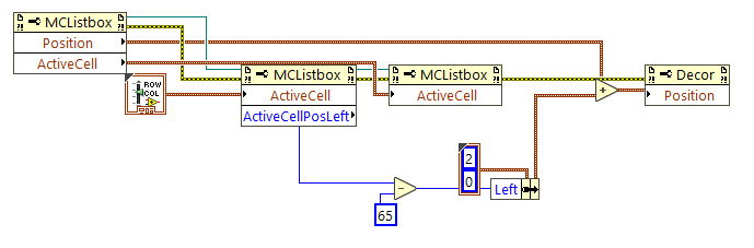

  2. I thought about making my own scroll bar for the list box, but I would not be able to use smooth scrolling as the property "Active Cell:Position Property" is read only. I could make/use a scroll bar to scroll column to column though as a work-around.
  3. I can do something "clunky" like below on a mouse up/down event on the scroll bar. Here I set to a known active cell, find its position, and adjust the position of the decoration. However, it is not smooth.
Any suggestions or workarounds?

@Ben wrote:
Property >>> Top left visible cell
Ben
Yes, you could use that in combination with the Active Cell Property. Get Top left visible, set it to active cell, and get its left position. However, it is easier to "pick" an known active cell as a reference, get its left position and adjust from there.
This works. However, ...,
the property is only updated on a mouse down or mouse up event.
So assume, I mouse down on the scroll bar, I get an Event update, I do not let go of the mouse down while scrolling. I get no updates until a mouse up event. So while the user is holding down the mouse and moving the scroll bar, I cannot adjust the decoration position on the "fly". It can only happen at the beginning and ending of the event. This is why in my initial post I mentioned this solution as clunky.
Right now I am leaning towards making a custom scroll bar that moves column to column. Then I can monitor the value change event continuously. What I don't like is I will have to modify my tree control to have the same behavior as the listbox as I want "consistency" for the UI.

I am going to leave this post open in case a better solution comes up, but I made my own horizontal scroll bar and now move the listbox column-by-column.
But let me gripe a bit, the solution is odd.
I have a tree control right above my listbox control. (See photo) For the tree I have both scroll bars on, vertical and horizontal. For my listbox if I turn off its horizontal scroll bar the vertical one extends and that little square with the arrow pointing to it is gone. So to have my controls look similar, I need to keep the horizontal control for the listbox on, and place my own control over it, so I still have a square there. Hopefully it doesn't lead to any interesting race conditions between scroll bars. 🙂
mcduff
