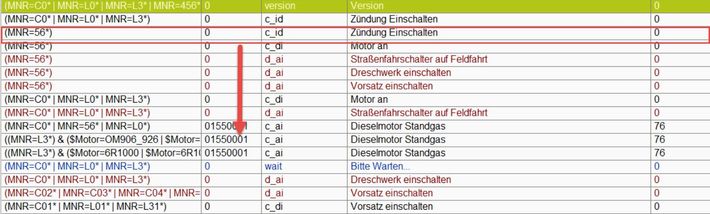

My user adds a new line at the red position. Then I have to recolor every single line after that. And there are sometimes above 1000 lines.

Yes, after reading your first post more carefully I realized my misunderstanding. And now I see, you mean the Font-Color, not the cell (background) color. The performance of this is very poor, see my third testing- VI. I think, GerdW's suggestion is the right way- first recolor all visible lines, then all the others.
