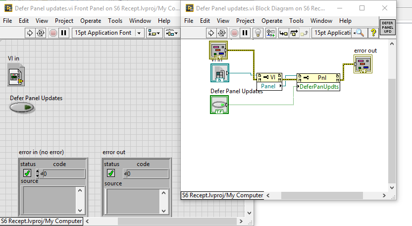

Hoovah and pincpanter, I tried Defer panel update, but it does not work. Meaning that I still see the updates during the time I have defer_panel_unpdates=true. Can you see the fault in my code? I put the functionality in a sub vi, as attached. Before my loop that extracts data from db and updates the multicolumn listbox, row by row, I added the following. With a similar call with false afterwards.F

For this issue I don't think Defer panel updates is the solution, see next post, but I like to be able to use it in other situations. I have a program that works poorly on slow pc's due to many control updates for example, and here the defer panel updates could really help.

As for the defer front panels I think you are doing it right. Here is a post on the idea exchange which shows the most basic calls which looks like what you are doing.  If you do try using this method, be sure and clear the errors before going into the undefer.  If an error happens between defer, and undefer, it won't ever undefer and your UI will look like it is locked up.
