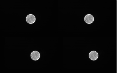

thank you for your work. I have tried to use your VI, but I am having problems. The image should look something like this:

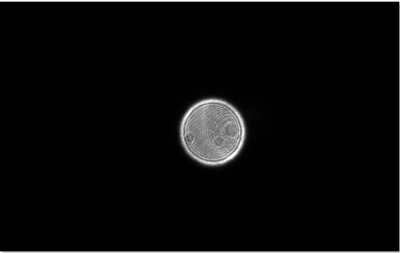

But what comes out looks like this:
Also, some viewers in Windows 10 are having problems displaying it. It does have 2 pages though, as it should, and they should be the same. I am using Labview 2018SP1. Do you have any idea, what is going wrong? Thank you.

which type of data are you trying to write as TIFF images? Could you also share the code you are using? I suspect something is wrong with the bit depth.

Hi, thank you for the quick reply.
I am working with U8 and SGL 1920x1200 pixel images, and I made sure that all images are U8. I just tested it again, specifically recasting to  U8, still the same result.
