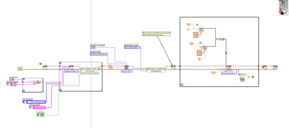

I recreated the problem with a cDAQ-Digital-IO-module.
I used the express-vi, teared it into pieces and added the signal stuff. Right now it is configured for 1kS/s and 1kS are written per second and 1kS/s are created using the signal-vis. This means 1000 samples per second created, 1000 samples written to the output and 1000 samples played in 1 second. This should result in a loop rate of 1s.
This vi is just an example, how it could work. Since I used analog signals and digitals IO-modules, it shows an error. Furthermore, I dont know, if the settings fit your setup.
