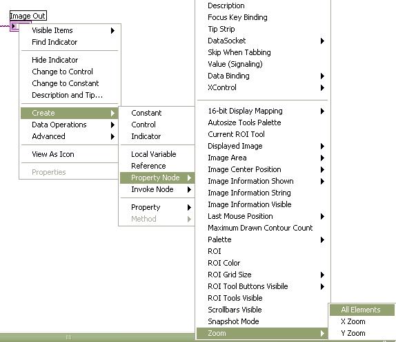

Use can use a zoom property
18839i5D96C974FDCC8E99
Remember you can verwell feed a negative value in the cluster.

Hey Muks,
thanks for the info, though that isn't exactly what I was looking for in the original question (actually, I've posted another question about zooming within the ROI if you happen to know anything about that and is what I wouold like instead of this). This question involved putiing the zoomed images within one image display rather than seperate ones as you have shown (and what I was able to do). However, I have rethought this out and figured it would not be best for what I need. Rather, I'm trying to just zoom within an ROI that can be drawn by the user, but that is turning out to be problematic (coding wise at least for me). Thanks for responding though 😄
