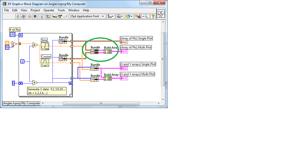

After you get an array of x/y-bundled points, bundle that array and build it into another bundled array of x/y points.
In the detailed help for the xy graph, there is an example under: Displaying Multiple Plots on XY Graphs.

If you look at the snippet I posted I have done that, but it only produces 1 plot. Both datasets are plotted, but they behave as one plot for property node purposes.
I have two x-y clusters of data that is built into an array, sent to the buffer, and sent to the xy-plot. I think because of the buffer it sees this as one plot. I think I need 2 buffers, but I can't figure out how to implement it.
The example you suggested I look at is not realtime plotting. I must be able to plot both sets of data in realtime for it to be useable. i.e. something involving the xy-chart buffer, as I have shown in my snippet.

No you didn't. And if you use the XY Chart instead of the XY Graph, it handles the buffer for you.
Edit: Oh, you mean the bottom example.

The XY-Chart Buffer does not accept the array after I added those single bundles (which doesn't make sense to me to even do). Nor can I find the XY-Chart. I tried searching for the indicator, and searched the help pages looking for it. Where is this XY Chart located?

Thank You Todd! That was exactly what I was looking for. I am still not sure I fully understand this single bundle stuff. I guess it is just recasting the data into a different form that it better understands.
Now to format these two plots.
