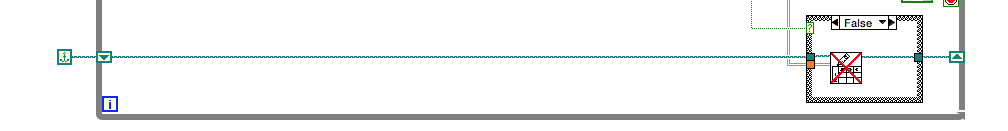

This is what Ravens Fan is suggesting. The initialization of the shift register with Empty Path constant will cause the Spreadsheet VI to ask for a file path the first time the OK button is True. On any subsequent iteration it will use the same path from the shift register.  The False case has the path wired straight through.
(Ignore the red X. The Spreadsheet VI has changed in LV2015).

I just added the shift register to your VI.  I moved the case structure down a little so the path wire could run straight across. You could modify your VI faster than I could save the modification a for a previous version and post it.  Besides, I already disposed of the changes so I would have to do it over again.
 You will learn more by doing it yourself.
Lynn
