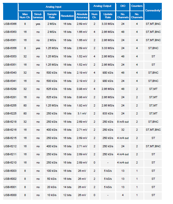

Hi Thank you for your speed answer.
I understand better the probleme of this DAQmx 6001 ! So do you have any other solution to recover the temperature from a thermocouple ? I'm thinking to use a µC ( for exemple Arduino) and combine it with Labview.. Do you think it  will be better ?
Take a look to this, My daq is the DAQ 6001 and in the case of simultanous analog input : no..
SC
Message 12 of 13
(609 Views)
Hi Soucha,
AFAIK the Arduino ADC is not as good as that of the USB-6001…
"Simultanous" denotes the ability to measure several channels at exactly the same time (in parallel).
Your USB-6001 still can measure several channels, but in a multiplexed (interleaved) way as it only contains a single ADC circuit.
I would use an amplifier for the TC signal, similar to this one.
