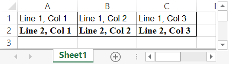

Yes, if you use the Excel Easy Table function, you can make each line a different font.  This took me about 5 minutes to code (including defining the contents of the cells).  Note that Lines 1 and 2 have different Font names (Arial and Times New Roman), sizes, and Bold setting.
I've told you what you need to do this.  I expect you to "do it yourself", as you will learn a lot by giving it a try (don't forget to use LabVIEW's excellent built-in "Help" for its function).  If it matters, I'm using LabVIEW 2016 and Office 2013 on Windows 10 x64.
