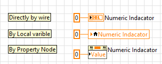

I am not sure if I understand your question but...
In general there are a few basic ways update an indicator.
=== Engineer Ambiguously ===

@RTSLVU I have tried using the directly by wire approach but trying to connect two outputs to the same indicator does not work as you can see in the image I have attached. I will look into the local variable and property node approach next and post here again with how I progress.

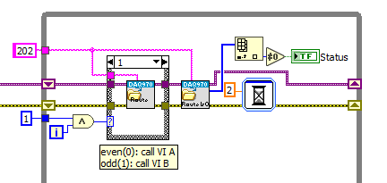

If there is only one U16 valuein that blue array wire, use index array to get the first element. Connect the the scalar terminal to one of the blue wires and a local variable of it to the other blue wire.
If you want a boolean instead of the 0 or 1, do a "not equal zero" on the value.
(There are probably better ways. For example if you would turn this into a state machine, you would not need the local variable and you could eliminate some of the duplicate code, i.e. only one instance if the tool that outputs the blue wire and one instance of the time delay. Why do you think you need four instances of a "202" string? Wouldn't one be enough?)
Here's how that could look like... (modify as needed)
Basically, the loop runs twice as fast, alternating between the two states based on even/odd of [i]. You need to decide where the delay should go.
