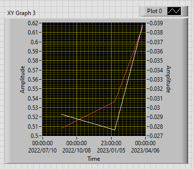

I'm trying to draw multiple plots on an XY graph, which would use same X axis, but with possible missing or extra data points than original X axis.
The X axis is a time stamp and the length of the axis should be the same for all plots, but some data points could be extra or missing.
Like this, except with multiple plots on the same axis.
