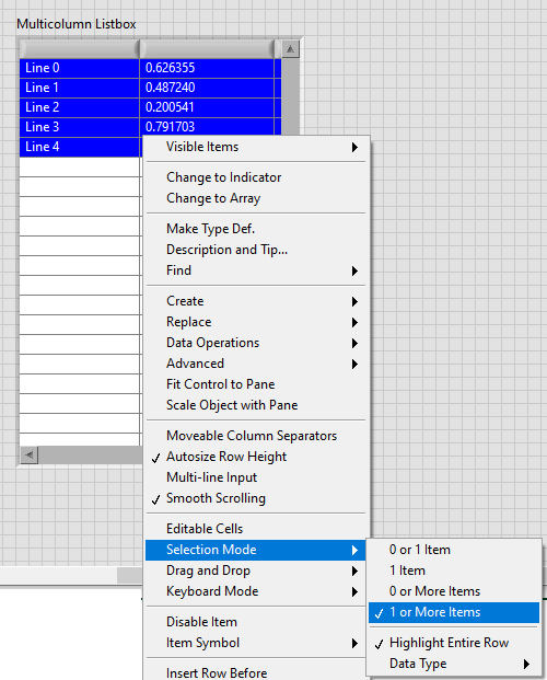

I mistakenly wrote a long response to this, but actually the better answer is as follows:
@AeroSoul wrote:
I was wondering if there is a front panel item that would behave as an excel table in a sense that you could select multiple cells by holding down CTRL (to select multiple different items) or SHIFT (to select a range of items).
I have tried Multicolumn Listbox, which only allows a single item selection,...
The bit in red isn't true - right click on your listbox and go to Selection Mode, then choose "1 or more items" (or 0+, if you want to allow no selection), then perhaps also choose "Highlight Entire Row". The default datatype becomes an array of indices selected.

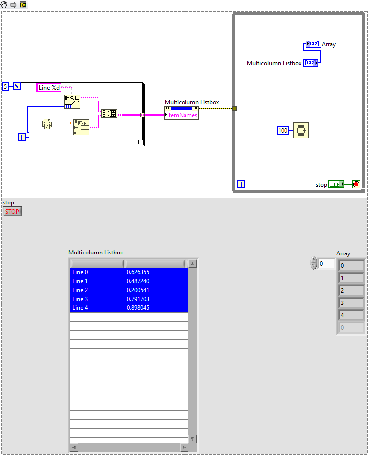

See the following example:
This (at least in 2019) allows the Ctrl / Shift behaviour you wanted.

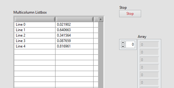

This shouldn't happen - if you want to allow not having anything selected, make sure you have the selection mode set to "0 or more items" and not "1 or more items".
Then, the default output (without nothing selected) should be an empty array, like this:
until you select something. (The elements in "Array" are all greyed out, indicating they're empty).

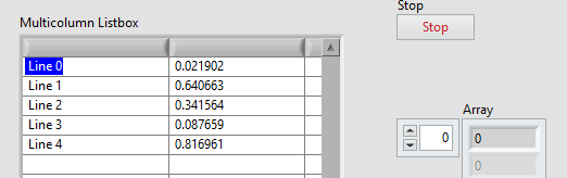

A selected row 0 would appear like this:
(I failed to select the "Highlight Entire Row", so it looks a bit odd here, but you could choose that option too as I mentioned before and showed in my first post).
