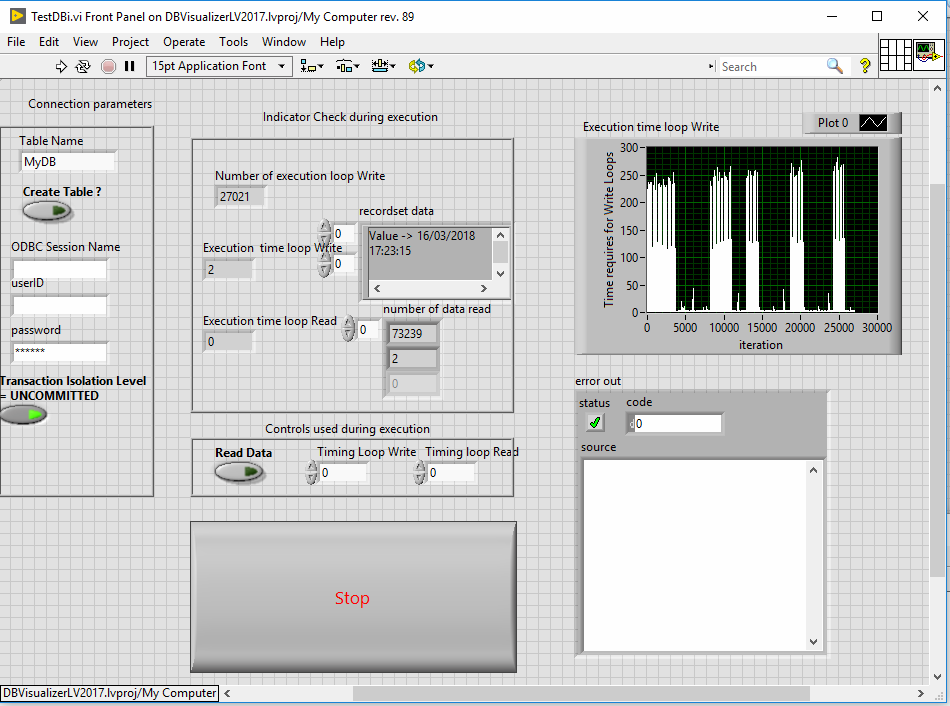

I include the (dirty) TestDB.vi that have two parallels loops, one for reading from the DB and one for Inserting data.   As you may see from the Screen shot, when the "Select" Loop is disabled, the time for the INSERT Loop execution takes few ms. But when the Select loop is on, it goes up to 300 ms (with 100 000 points).
