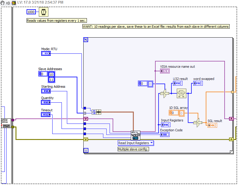

I wonder if I can have the slave ID as a constant like I have now in order to increment it?
Message 8 of 41
(8,256 Views)
No.  You need to think more about LabVIEW basics like how loops work, arrays work,  auto-indexing.
Like this.
mb_comm_multi_v1_3_BDmb_comm_multi_v1_3_BD
