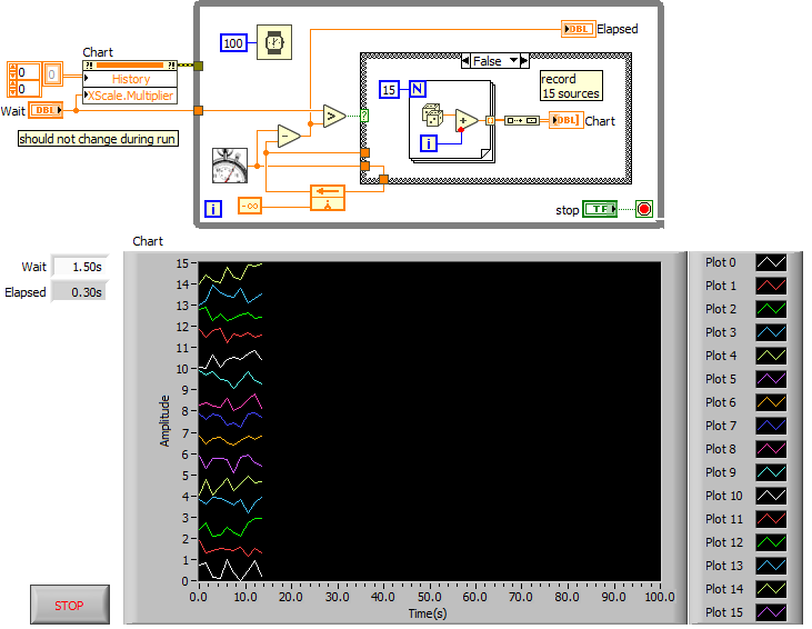

Here's one simple possibility using a chart. Maybe you can adapt if to your needs.
(2,290 Views)
thank youu so much it works well
