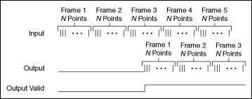

This figure is from the help section of the FFT and will help illustrate the question:
There is a reset terminal for both the windowing and the FFT VI.
Are there any internal registers in the Windowing and FFT that forces Frame 1, Frame 2,... to be from the same signal or is it possible to first input in a frame from Ch1, the next frame belonging to Ch2, the next to Ch3 and so on and still get valid results?

What I meant was that Frame 1 for example would be from Ch0, Frame2 from Ch3, Frame 3 from Ch 2 etc (the frame number have no relation to the channel number and the channels are not necessarily in any particular order):
Frame 1, 1024 samples from Ch0
Frame 2, 1024 samples from Ch3
Frame 3, 1024 samples from Ch2
Considering that even if all frames came from the same signal:
Frame 2, 1024 samples from Ch0 (1024 new samples, not the same as in Frame 1 and no overlapping is done)
Frame 3, 1024 samples from Ch0
the frames could still be very different and contain completely different signals. Frame 1 could contain a broadband signal, Frame 2 a narrowband signal and Frame 3 just noise. If there are internal registers and accumulations in the FFT, that would affect cases with very varying signals in the same channel as well.

When using the LabVIEW FPGA FFT express vi and the scaled windows express vi the computations are done point by point so there will be no problem when passing through it different types of measurements. As a result, you should have no problem with your application.
