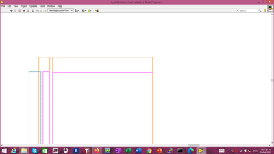

My block window is not working, it shows just some lines
Hi all!
when I open my block window, now it is not showing at all the diagram, but just some lines of what seems a write to file controller, I send you the image.... what can I do?
Thank you in advance!

Look at your scrollbars! You diagram is way too big. See here for details.

I've seen similar happen to me when I try to open up space on my block diagram with the ctrl+click/drag and I reach the edge of the window.  It starts scrolling like mad and I end up with a huge block diagram with stretched wires.  I wonder if that is what happened here?

If you don't think the contents are that large, you can try auto-cleaning the diagram (Ctrl+U, the broom on the bar above the diagram).
If not, try using the navigation window (Ctrl+N) to see 'where' the diagram is, and then move using that (dragging the window to the area with the code) and then right click on specific wires and choose to clean-up the wire. That might work more reliably.

Hi guys!
Thank you so much for your comments! They have been helpful!
