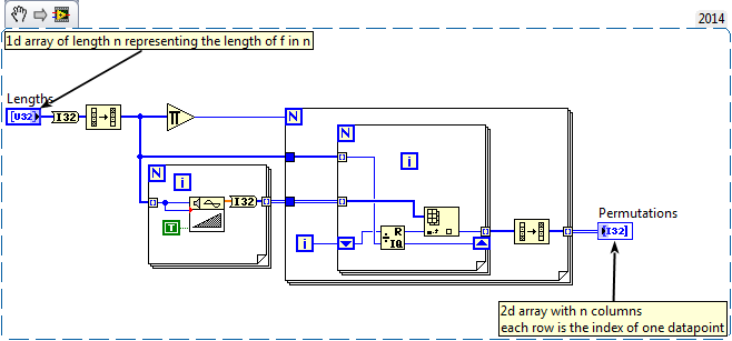

I don't think it is possible to create an array of variable dimension in LabVIEW. However, I have written a permutation VI which you could use to create an index for each point of the n-dimensional function f.
This is something which I'm sure could (and probably has) been written far more efficiently by others.

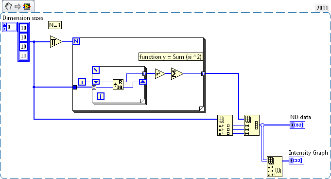

You can populate n dimensional function (below Y=x1^2+x2^2+...). Though you still need to connect 128 wires (index array-reshape array). Still scales better than multiple loops.
Intensity Graph is to view one slice.
There are 2 notes:
1) Above mentioned memory issues. 10 points to see gaussian in each of 128 dimensions, 10^128 array size. Nu-nu.
2) Labview wires have fixed data type. Changing array size means changing block diagram. So I would store N dimensional data in 1D array and write your own index array function. You just need to convert N indexi and N dimensions into "absolute" index. Like if you have 10*10*10 array and want to get element at (2, 1, 0) - least significant first, you need absolute index 11. This function approach is unversal and code will not change for different  dimensions.
